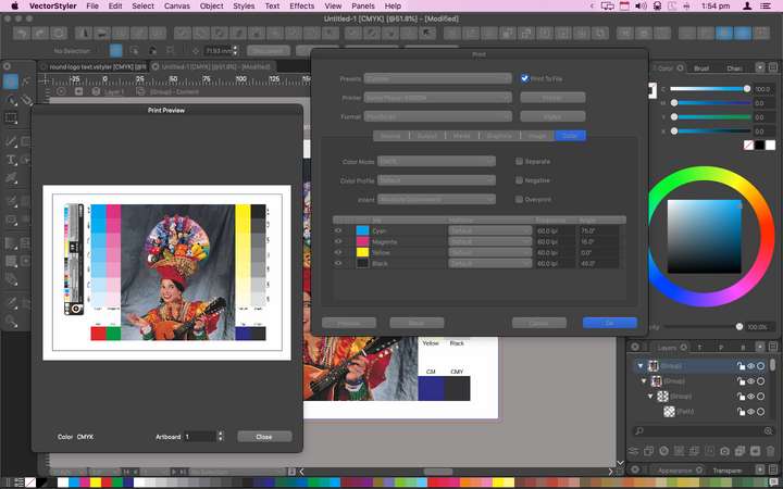

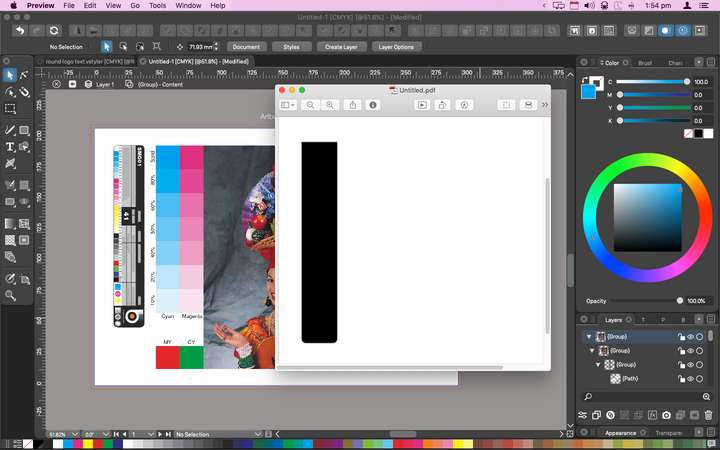

      I was initially really exited that the VS print interface looks well up to the job of printing decent CMYK proofs and even separations to ps devices, with all the options you'd expect from a pro graphics app, but I've spent a couple of hours messing around and can't seem to trick VS to print anything other than a 4 pass black fill in of a colour bar to my Xerox 6180DN - I've even tried printing to file and just getting the black bar - just wondering if I'm missing something or are the current options just a place holder for a finished interface?0_1634648822254_Screen Grab 2021-10-19 at 13.54.04.png 0_1634648832139_Screen Grab 2021-10-19 at 13.54.56.png

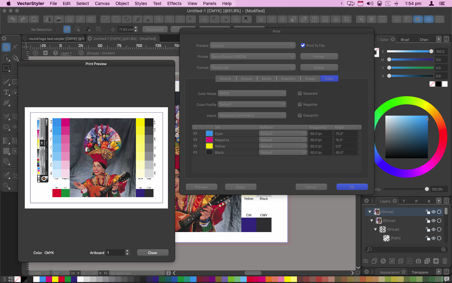

                        @vectoradmin no just a black bar where the vector information and text should be - tried using Xerox iGen / 6180DN + EPSON SX435 all the same result :0_1635790530377_Screen Grab 2021-11-01 at 18.11.48.png 0_1635790540753_Screen Grab 2021-11-01 at 18.13.08.png
