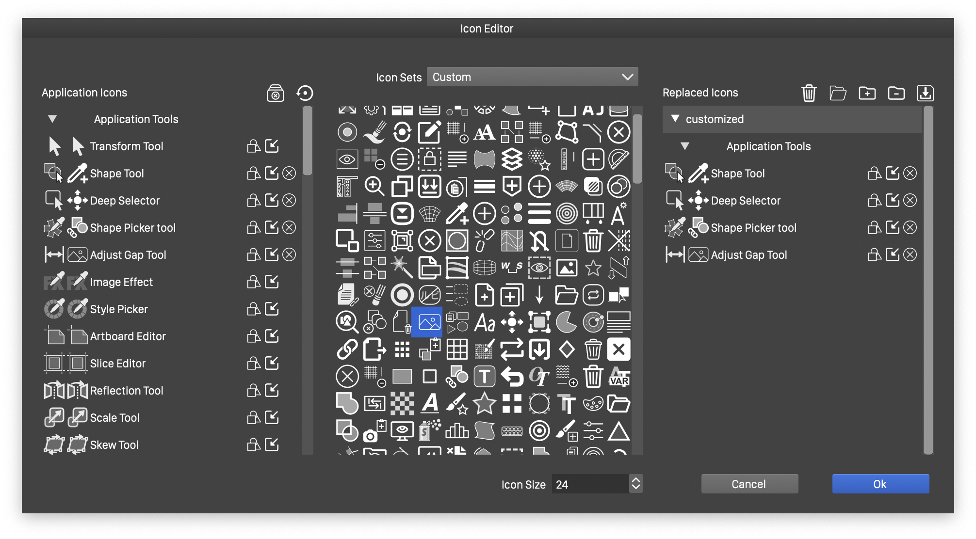

To customize the application icons, select the VectorStyler - Customize Icons on Mac, or View - Customize - Customize Icons on Windows. The Icon Editor view is shown containing the current and redefined icon sets.
The Icon Editor view contains three lists of icons as follows:
- On the left side (Application Icons), there is a list of the application icons. This list contains all the application icons, and it is organized into a hierarchy. The list shows the original and the current (customized) icon for the specific action, tool or user interface element.
- On the middle (Icon Sets), there is a grid list of icon collections that can be used for customization. The icons in this list are not part of the customized icon set, these are available to be picked to replace application icons. This list is created from a collection of icon set files and symbols by the user.
- On the right side (Replaced Icons), there is a list of customized application icons. This list can be separated into multiple sections if there are multiple icon sets used in the customization. This list is limited to the icons replaced by the customized icon sets. Just like on the left side, the right side list also shows the original and the customized icons.
To customize an application icon, use the following steps:
- Browse the list on the left side and select the icon.
- Find a suitable icon in the grid list in the middle of the view.
- Double click the icon in the middle list. If there are no existing customization icon sets (on the right side) the file save view is shown to select a file name where the icon customizations are saved. This file will contain a set of icon customizations. Once the file is selected (or if the icon set already exists), the selected icon is added to the customization and shown on the right side list.
- The icon can also be selected from a object preset or symbol of an opened document. To select a custom icon, click on the
icon in a row of the list on the left side. A popup menu is shown, containing a list of available symbols. Select a symbol and the icon is added into the right side list. If the right side list was empty (no customized icon sets defined yet) the file selector view is shown as described above. - The icon can be selected from file also. To select a custom icon from a file, click on the
button and select the graphics file containing the icon. - The
button can be used to restore all icons to their default state. - The
button can be used to restore the selected icons in the left side list to their default state. - The
button at the end of a row of the list is used to clear the customization of that single icon.
