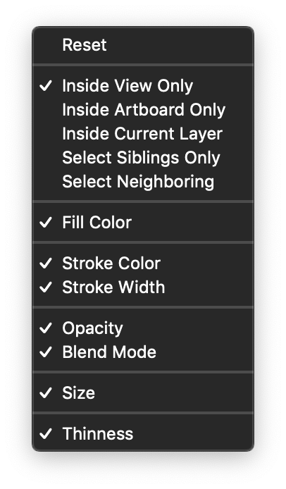

The Magic Wand panel menu.
The Magic Wand panel menu contains additional options, used to configure the panel, and to restrict the object selection scope.
- Reset - Restore the Magic Wand panel content to its default state.
- Inside View Only - Enable or disable searching for objects visible inside the current document view. When enabled, the document view area, zoom level and rotation angle is used to find objects that are currently visible on the screen. The Intersecting Selection option from the Select menu determines whether the objects must be completely inside the view, or can be partially outside.
- Inside Artboard Only - Check to only select objects inside the same artboard as the clicked object.
- Inside Current Layer - Check to only select objects inside the current layer.
- Select Siblings Only - Enable or disable the selection of objects in the same layer or group as the clicked objects. When enabled, only objects inside the same layer or group are searched. Otherwise all objects on the current canvas (or isolated context) are searched.
- Select Neighboring - Check to select objects immediately below or above the selected objects.
- Select Inside Shapes - Select objects inside the clicked shape.
- Select Intersecting Shapes - Select objects intersecting the clicked shape.
- Fill Color - Show or hide the Fill Color field from the panel.
- Stroke Color - Show or hide the Stroke Color field from the panel.
- Stroke Width - Show or hide the Stroke Width field from the panel.
- Opacity - Show or hide the Opacity field from the panel.
- Blend Mode - Show or hide the Blend Mode field from the panel.
- Area - Show or hide the Area field from the panel.
- Length - Show or hide the Length field from the panel.
- Thinness - Select objects with shapes matching the thinness of the selected objects.
- Path Nodes - Show or hide the Path Nodes field from the panel.
