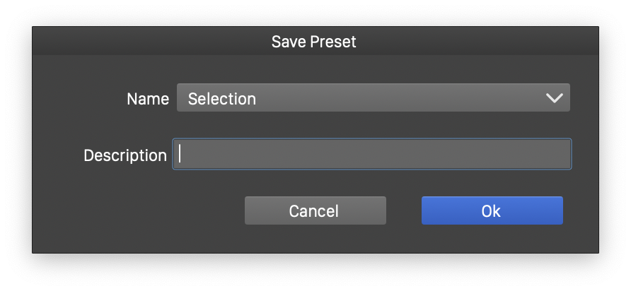

To save the current object selection as a selection preset, use the Save Selection command from the Select menu. The selection can also be saved, using the
button in the Selection panel.
In the Save Selection view, input the name and description of the saved selection. The name is used to list the saved selection in the select panel and Select menus. The description can be used to assign additional comments to the saved preset.
The saved selection presets will be listed in the Selection panel, and in the Selection command of the Select menu. To recall an existing selection preset, select the preset name in the menu opened with the Selection command of the Select menu, or select the preset in the Selection panel.
Saving an object selection.

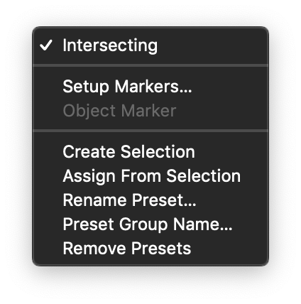

The Selection panel menu.
The selection panel provides a number of options and commands, accessible from the panel menu:
- Intersecting - Enable or disable the intersection selection mode. This option is the same as the Intersecting Selection option of the Select menu.
- Setup Markers - Open the named object marker manager view, used to create, edit or remove object marker names from the current document.
- Object Marker - Shows a list of available object marker names, used to make selections. The use of named object markers to create object selections is described in the Object Markers section.
- Create Selection - Create a new selection preset from the current selection in the canvas. The Save Preset view is shown to set the new preset name and description. This command is the same as the one accessed using the
icon from the panel. - Assign From Selection - Assign a new selection to the selected preset, from the current selection in the canvas. This command is the same as the one accessed using the
icon from the panel. - Rename Preset - Rename the selected preset. This command is the same as the one accessed using the
icon from the panel. - Preset Group Name - Rename the selected preset group name. The selection presets can be organized into groups, using the Preset Manager command from the Styles menu.
- Remove Presets - Delete the selected presets. This command is the same as the one accessed using the
