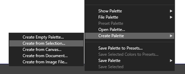

      Open a Palette Panel ( Window > Color Palette )
      and in the Panel Menu select
      ( Create Palette > Create Palette from Selection )
      Name the new Palette "2-colors" and save it.

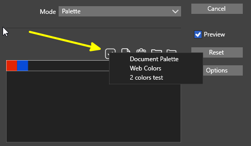

      While the objects are selected, go to the Menu and call the "Colorize" panel.
      (see above how) To call the 2-color Palette in the Colorize Panel click at the
      first icon here and select the palette.

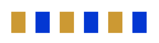

      The objects are now colored with the colors from the palette. You may have
      noticed the order of the colors: As you can see, the colors repeat regularly.
      This is the Point where I will show you the possibilities that arise from this.

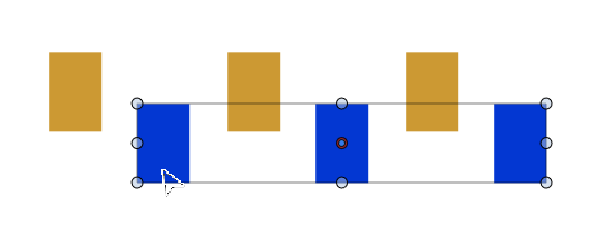

      Call up the Magic Wand Tool and select a Shape.
      You'll notice that all objects with the same color have been selected.
      Using the method described, we are able to created
      a kind of pattern selection.
      Wherever we want to select every second, third or xth shape,
      we can do so using the method described here and creating
      a corresponding color palette for this. Of course, other patterns
      can also be created.

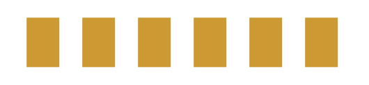

            Here an Example

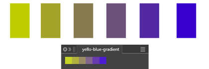

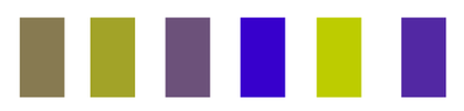

            I used Blend to create a gradient from some shapes and arranged them
            in a random order.
            Then I took the Shape Builder Tool, selected any color and selected all
            objects with the tool in one direction
            Finally I select the shapes and color them using the "Colorize" Feature.
            You can see all shapes are colored in the order of the palette.

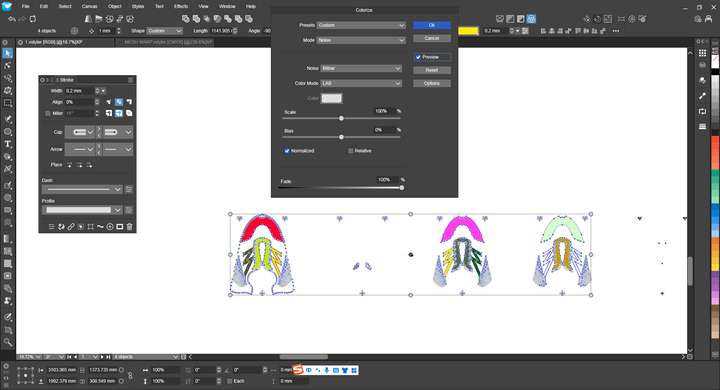

                            @Subpath The file contains 4 to 5 groups, with both paths and fills in black. I want them to appear as separate, independent shapes and automatically change into 4 to 5 different colors.
                              Subpath @monsterfox
                              @monsterfox
                              I've been experimenting a bit with the designs in your file.
                              Separate filled shapes and outlines
                              Filled objects can be separated from outline objects.
                              By selecting filled Shapes via.
                              Menu > Select > Styling > Filled
                              and move them to another Place
                              Coloring Shapes
                              Coloring your Designs via Colorize makes no sense to me.
                              The Designs differ to much, have different number of objects
                              and/or the object order is different.
                              I developed a way, but I don't know if it will work for you.
                              It uses the "Selected Intersecting Shapes" feature to select shapes.
                              You could color them then.
                              The Video here show the Steps needed
                              Once the shapes are colored, you can select them
                              with via the Magic Wand Mode for selecting shapes.
                              Or via the way i showed in the Video.
                              Important!
                              The color for the circle is for selection purposes only.
                              So this color should not appear in the Design.
