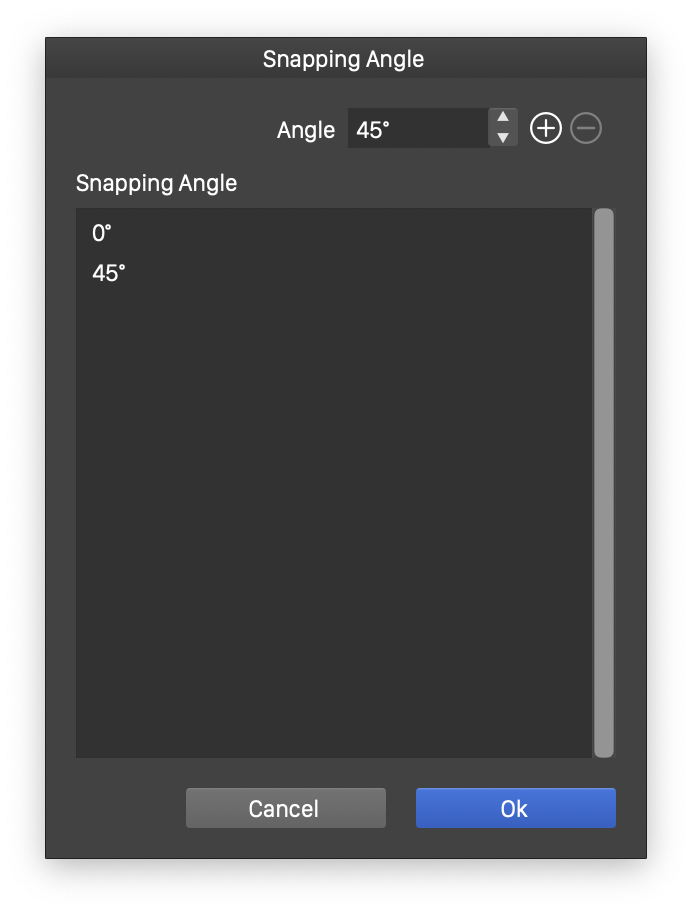

Custom Snapping Angles
The Snapping Angle editing view.
The custom snapping angles are be used when snapping to object bounding boxes, when the Snap to Objects option is enabled. By default, the object bounding boxes are snapped to the zero angle in the document space, and at the current document view rotation angle. Additional angles can selected on individual objects (see the object snapping options), or for all object snapping.
The editing of custom snapping angles, is done in a similar way as the editing of custom size ratios, described earlier.
