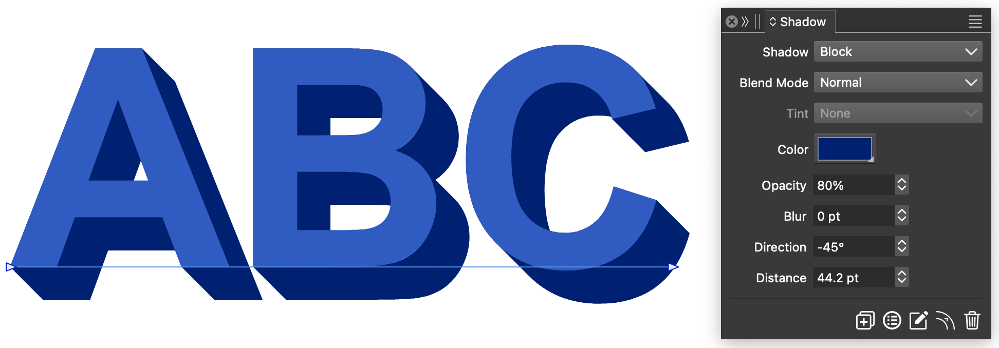

Drop Shadow of Block type

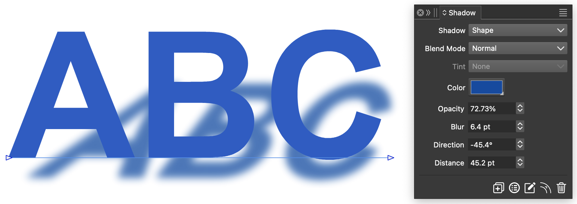

There are three shadow types:
  • Shape - Use the object’s shape to create a distorted or perspective shadow filled with a solid color.
  • Block - Create a block shadow using a filled shape.

A block shadow.

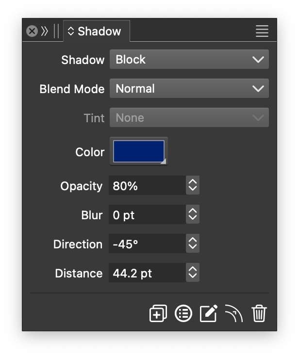

Drop Shadow Panel
The Drop Shadow panel.
Use the Drop Shadow panel to adjust the selected object’s shadow:
  • Shadow - Choose the shadow type.
  • Blend Mode - Choose the shadow’s blend mode.
  • Tint - Adjust the shadow’s colors when using the Object shadow type.
  • Color - Set the shadow color. For the Object type, this color is used with the selected Tint mode.
  • Opacity - Set the shadow’s opacity.
  • Blur - Set how much the shadow is blurred.
  • Direction - Set the shadow’s direction.
  • Distance - Set the distance between the shadow and the object.

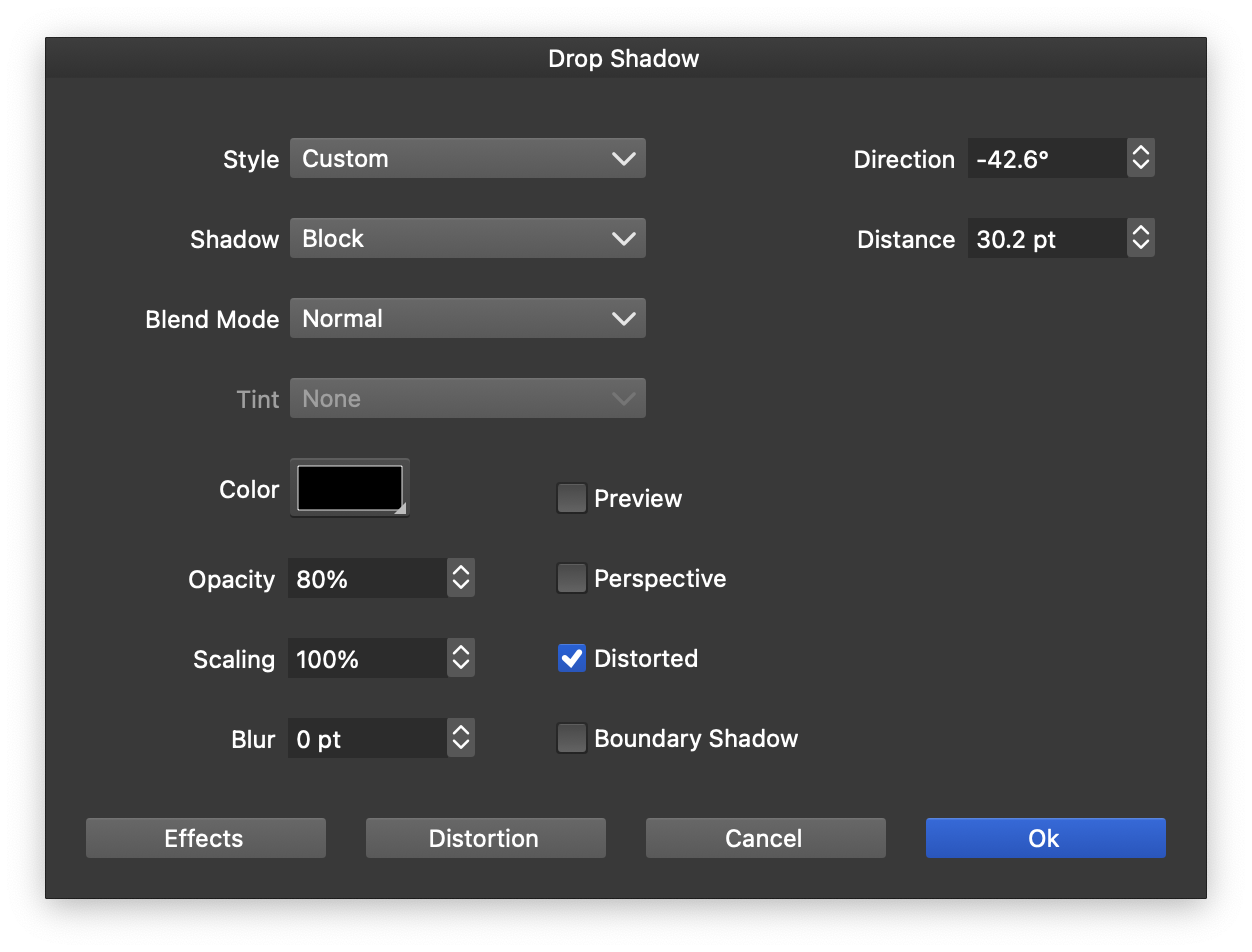

Drop Shadow Options
Drop shadow options.
Select an object with a shadow and choose Styles - Drop Shadow - Drop Shadow Options. The following options are available:
  • Style - Create or reuse shadow effect presets or styles.
  • Scaling - Set the shadow’s scale.
  • Perspective - Apply perspective distortion to the shadow.
  • Distorted - Apply the object’s shape effects after creating the shadow, so they also distort the shadow.
  • Boundary Shadow - Use the shape boundary as the shadow.
  • Effects - Add image effects to the shadow vectors.
  • Distortion - Add shape distortions to the shadow vectors.
When Perspective is enabled, these options are also available:
  • Angle - Set the perspective angle.
  • End Scale - Set the scale of the perspective’s ending edge.
  • Start Scale - Set the scale of the perspective’s starting edge.
  • Shift - Set the offset of the perspective’s ending edge.
  • Stretch - Set the length of the perspective shadow.
