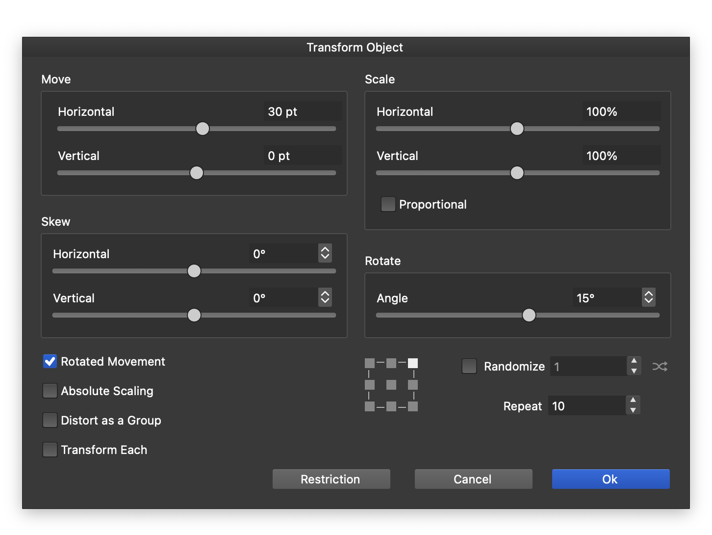

Use Transform Group to create repeated, transformed copies of an object or group. You can edit the transformations after applying them.
Choose Object - Transform - Transform Object to open the transform group options. Set the repetitions and transformations, then confirm to turn the selected object into a transform group.
  • To edit the effect, click Transform Group in the Appearance panel.
  • To remove the effect, remove its Transform Group item from the Appearance panel.
  • To expand the effect into separate objects, choose Styles - Expand Group.
Transform group options.
Movement, scaling, skewing, and rotation can be applied incrementally to repeated copies. When randomization is enabled, these values set the upper limits for the random transformations.
The following options are available:
  • Move - Set horizontal and vertical movement for the object or its copies.
  • Scale - Set horizontal and vertical scaling.
  • Proportional - Use the same scaling amount in both directions.
  • Skew - Set horizontal and vertical skewing.
  • Rotate - Set the rotation angle.
  • Rotated Movement - Rotate the movement direction by the rotation angle.
  • Absolute Scaling - Choose whether scaling uses absolute or relative percentages.
  • Distort as a Group - Apply distortion effects after creating the transformed copies. When disabled, distortion effects are applied before copying and transforming.
  • Transform Each - Transform each object in a group separately.
  • Add New Transform - Add a new transformation to the selected object.
  • Symmetric Random - Randomize transformation values in both positive and negative directions.
  • Incremental Transform - Increase the transformation values at each step.
  • Merge on Expand - Merge shapes when expanding the transformation.
  • Randomize - Randomize transformations using the selected seed.
  • Repeat - Set the number of copies of the original object.
  • Restriction - Open the transformation restrictions. For example, you can limit rotation to 10-degree increments.
Transformations use the pivot chosen with the transform center control.

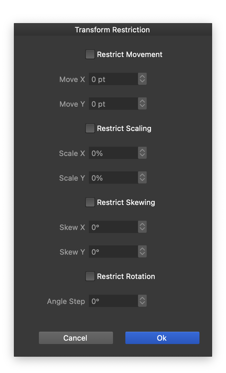

The restriction dialog contains the following options:
Restricting transformation amounts.
  • Restrict Movement - Limit movement to increments of the specified values.
  • Move X/Y - Set the horizontal and vertical movement increments.
  • Restrict Scaling - Limit scaling to increments of the specified values.
  • Scale X/Y - Set the horizontal and vertical scaling increments.
  • Restrict Skewing - Limit skewing to increments of the specified values.
  • Skew X/Y - Set the horizontal and vertical skewing increments.
  • Restrict Rotation - Limit rotation to increments of the specified angle.
  • Angle Step - Set the rotation increment.
